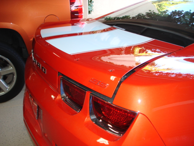

BEFORE
Start by opening the trunk and removing the eleven push pins and the trunk latch cover.

After removing all six of the 10 mm nuts, there will still be a push pin holding the spoiler in place. With some gentle pressure and compression of the pin, the spoiler should seperate pretty easily.
Naked rear end....

one note.... only 5 of the 6 holes lined up which was close enough for me....
note #2.... during installation be very careful not to cross thread.... use an old time regular screw driver so you have better control on the torque.... no cross threading!
here are my before, during and after pics
