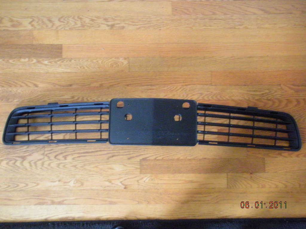

This morning I finished a few small details on what will be my permanent plate mount. The prototype that is pictured on my car is made of aluminum, the final product is the oem plate mount cut down and fitted to the oem grille and welded in place. Here are a couple of quick pics of both the prototype and the finished one.
